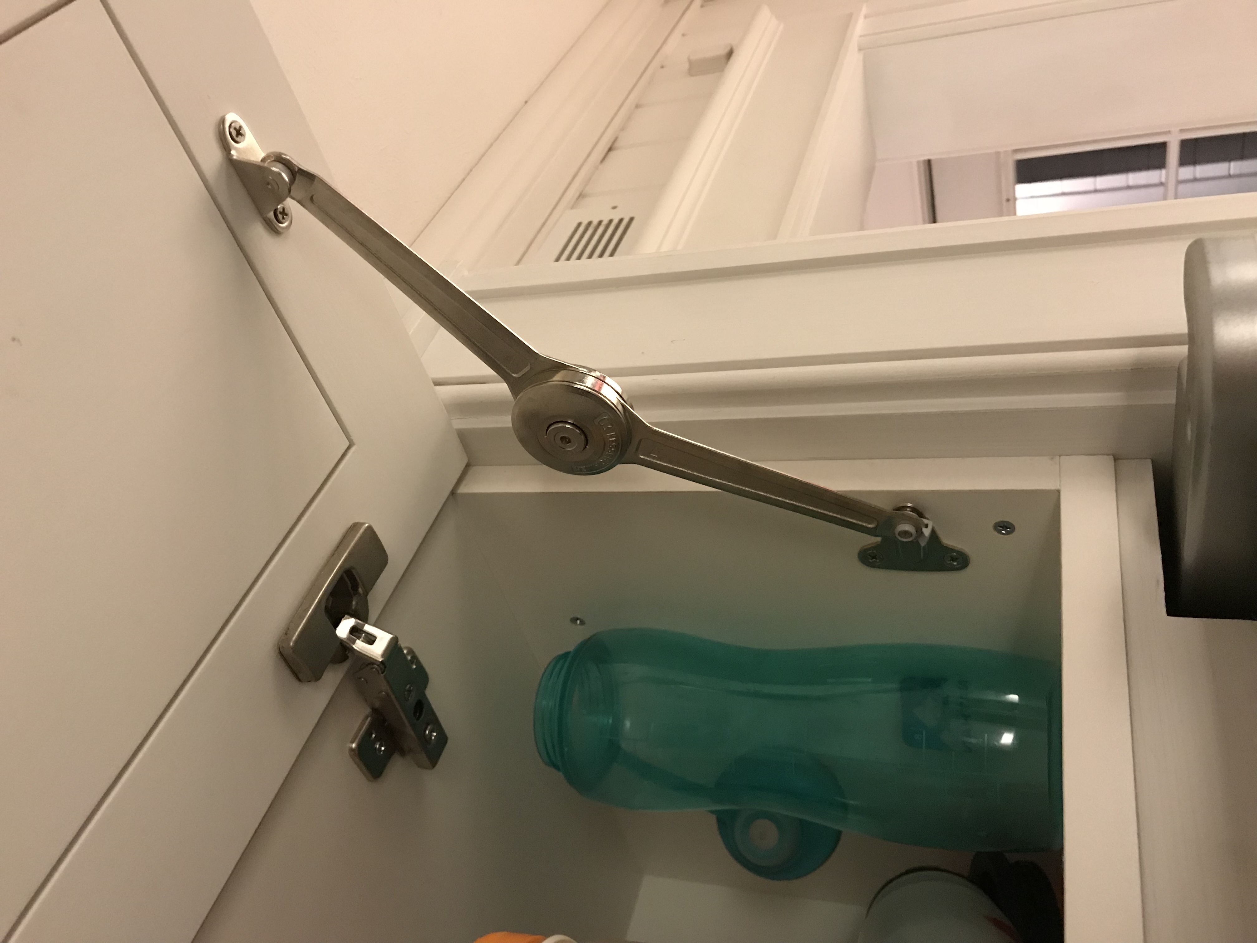

Matt Calnen
I’ve been using this one from the Richelieu book. It’s not fancy, but you can adjust the friction to the weight of the door so it functions real nice for a wide range of door sizes.

Bruce H
The Blum lift stay is deluxe. About twenty dollars per door, way easy install and we use our normal hinge. doesn't get any easier.
