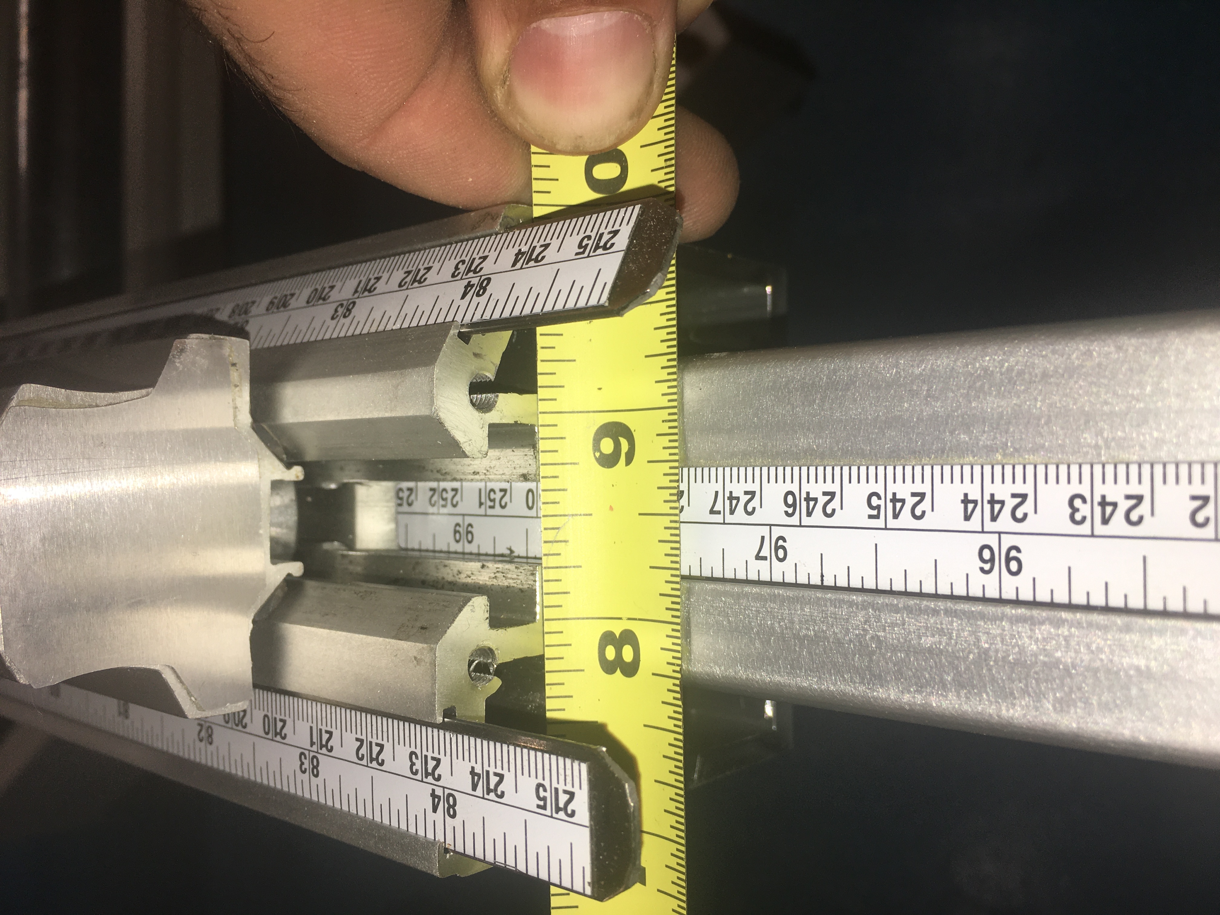

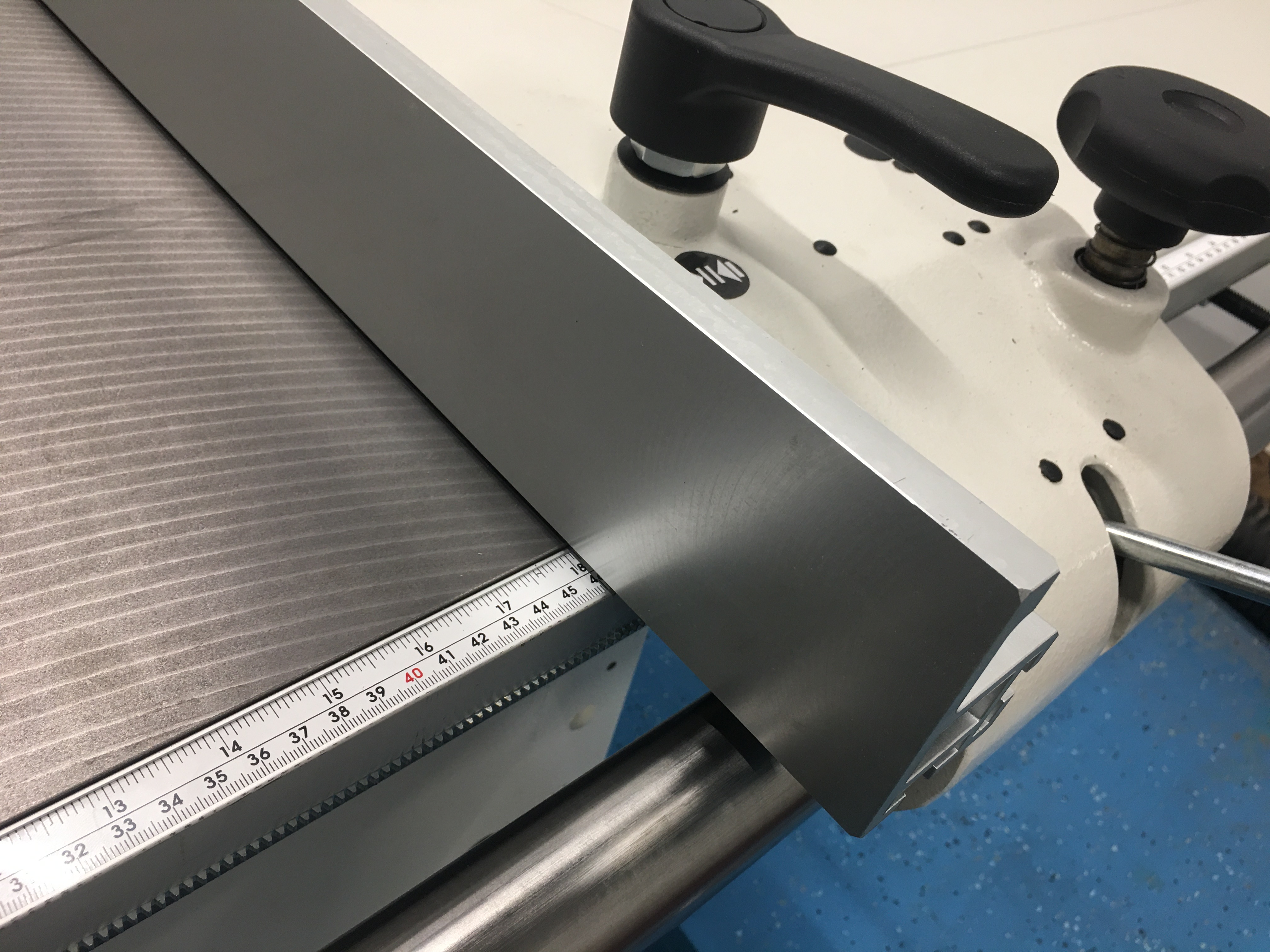

Unlike my Grizzly table saw that has relatively nice magnifying glass style position indicator with visible red line gliding just a hair above the ruler, my SCM sliding saw has nothing of a kind; the rip fence itself and the movable/lockable brackets on the crosscut fence seem to be the only "aiming devices", and since there is a big gap between ruler tape and the fence/bracket edge accurate positioning becomes tedious. (See the photo below)

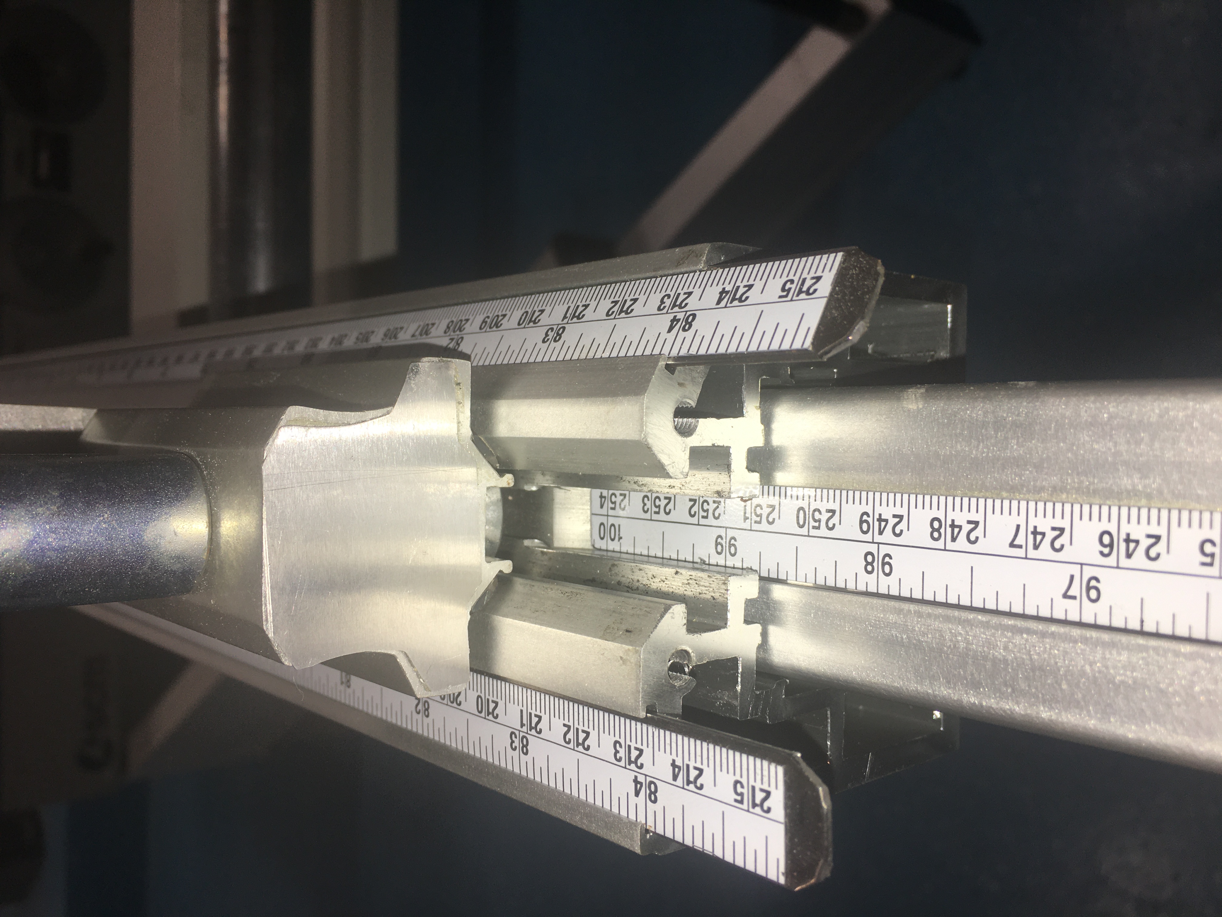

By looking at the pictures does anybody knows of any available devices that would fit this fence's size and shape?

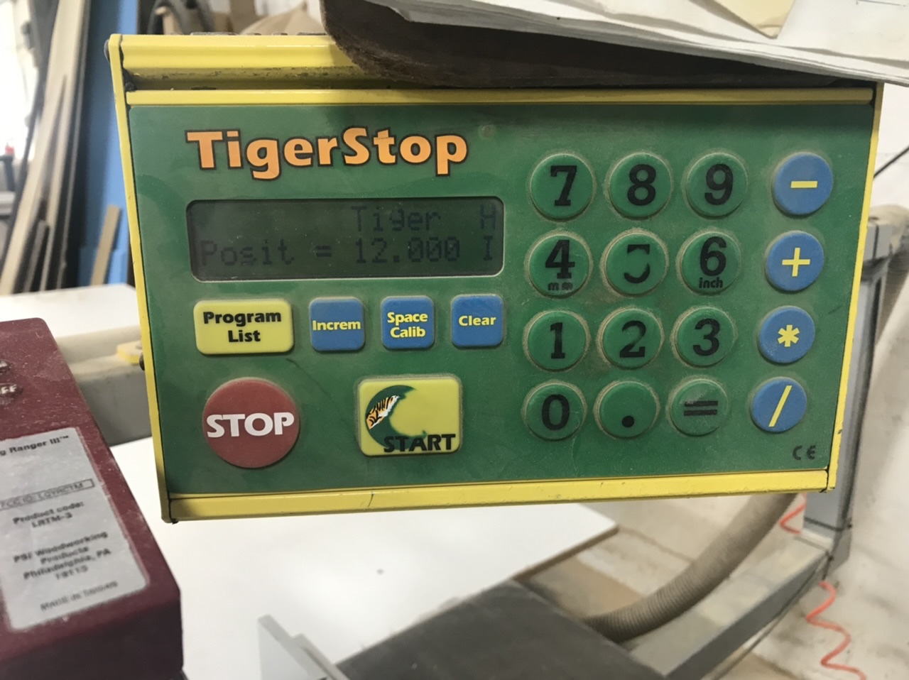

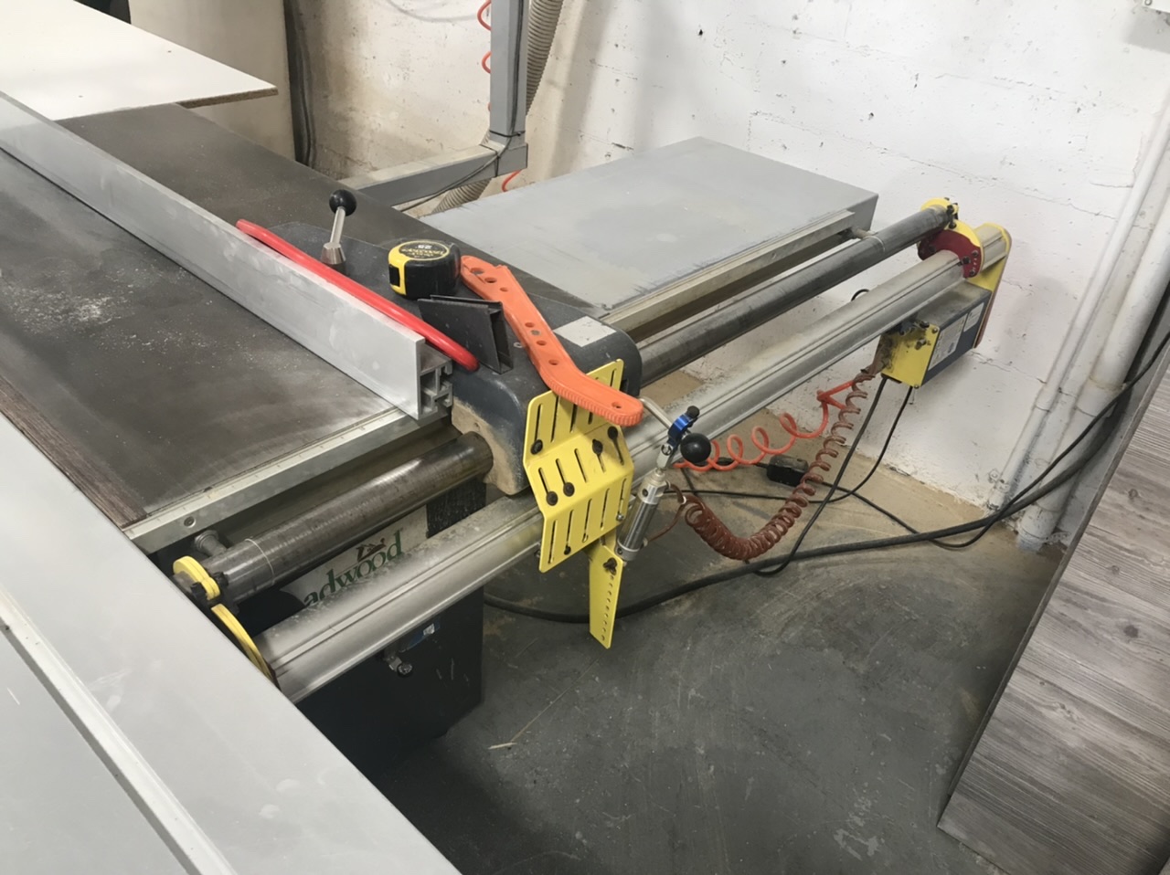

we have been using the tiger rip fence on both our sliders for years. Our original one works with air and electricity and we have had it for 16 years. Still works like new. Our newer one is only electric and does the same job. If you do a lot of cutting, it will pay for itself in a few months in saved labor. I am attaching two photos of my older one which is still on the saw. We just received a newer model to replace it because there was a screw that had fallen off and no one noticed it and we were not getting accurate measurements. My guys found that screw under the saw in the dust, put it back on and now it is perfect again, but in meantime the new one was already shipped. I will be posting it on the machinery exchange today at 2k, pick up only in Fort Lauderdale in case anyone is interested.
A slider with computerized rip fence integrated is pretty costly, but this s a great alternative.harold
