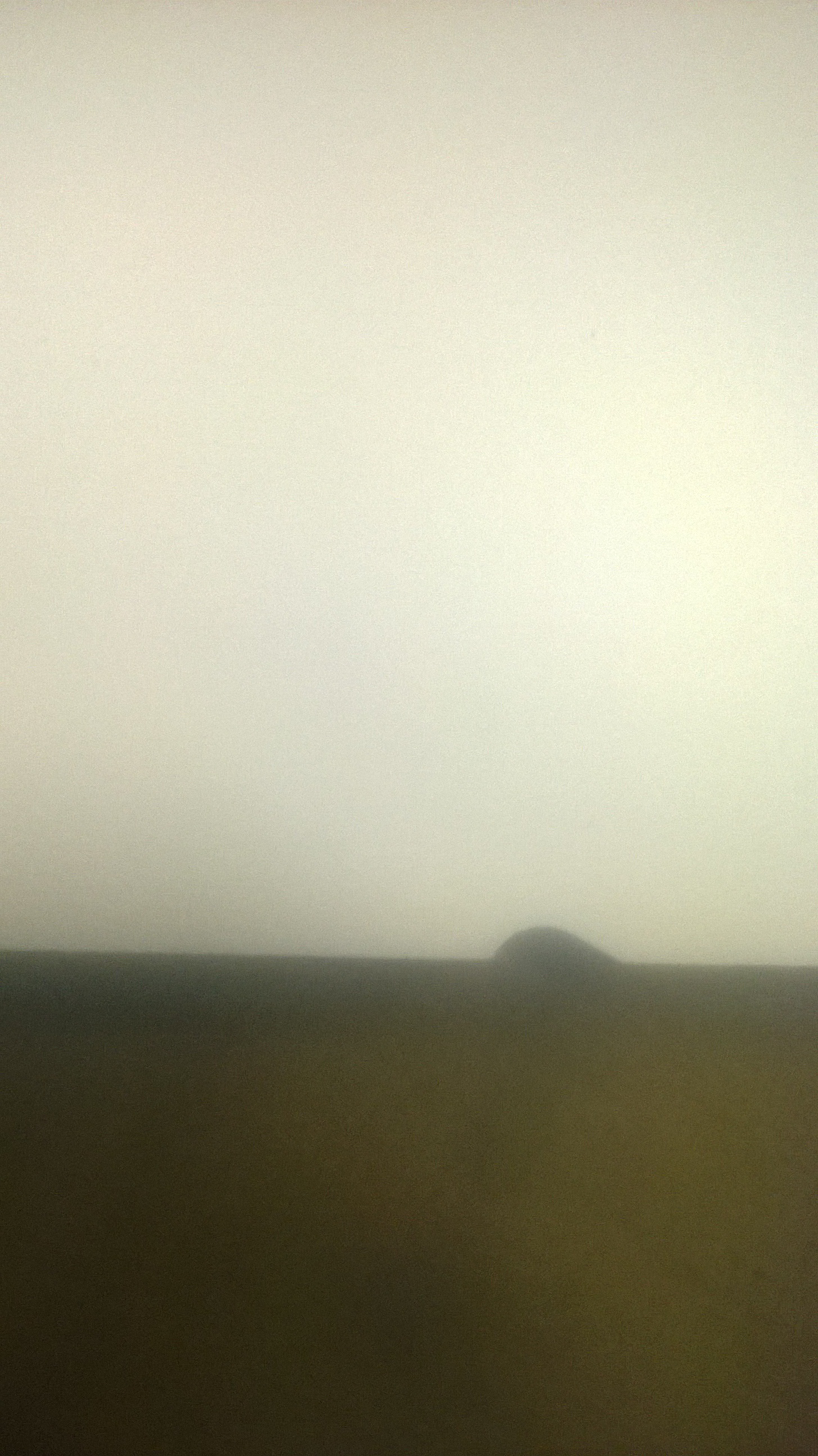

Hello everyone,
We have a Biesse/Microvellum setup and there has been a problem that has surfaced recently. The router cuts the outside profile and then right before it leads out it dips into the part. Sometimes we can work around it but many times I have to re-cut manually. Anyone had this issue in this configuration? Your help is much appreciated.

It is a nested part and it does seem to be related to the lead out but It only becomes noticeable after microvellum converts the machining.

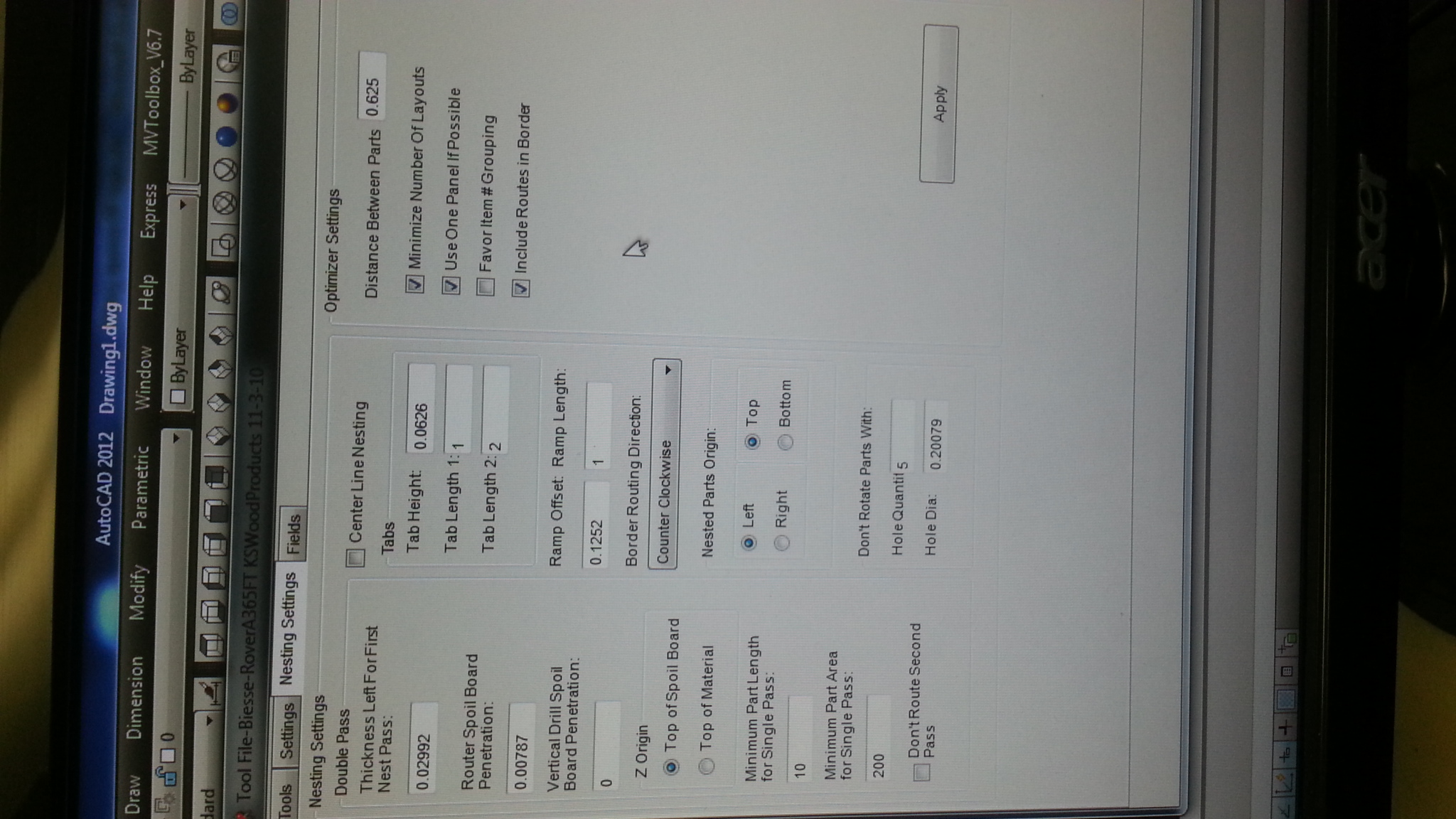

1/28/15       #8: Biesse/Microvellum code error ...
Alien Member
Have you changed bit size or Space between panels? Go to tool file under nesting tab and read over the values. I will look on mine and see if anything pops out. What machine is it? V6.7 or v7
1/28/15       #9: Biesse/Microvellum code error ...
cabinetmaker
you are going o have to look @ the last lines of code of a good posted nest and the bad. This will give you the insight you need
1/28/15       #10: Biesse/Microvellum code error ...
Alien Member
This is my nest settings
1/28/15       #11: Biesse/Microvellum code error ...
STEVEN
The part spacing is good, my settings are much the same Im trying to examine the code but taking me some time. Im not familiar with this method
