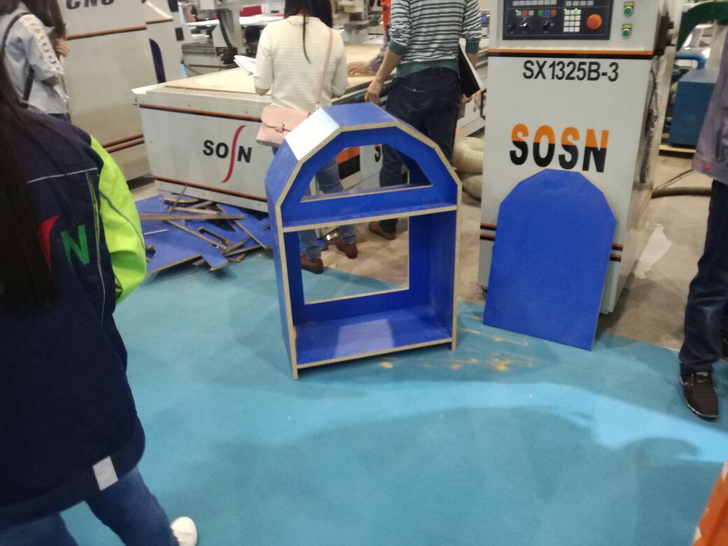

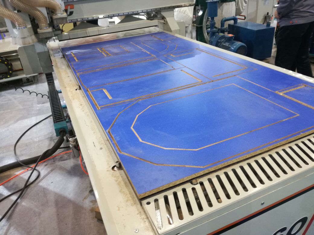

katz Yaakov
with poly board +knest only software
you can do any shape any angle
with....
simple tool
this cabinet created in last exhibition in Guangzhou last week with simple cnc without even tool change
View higher quality, full size image (1040 X 780)
