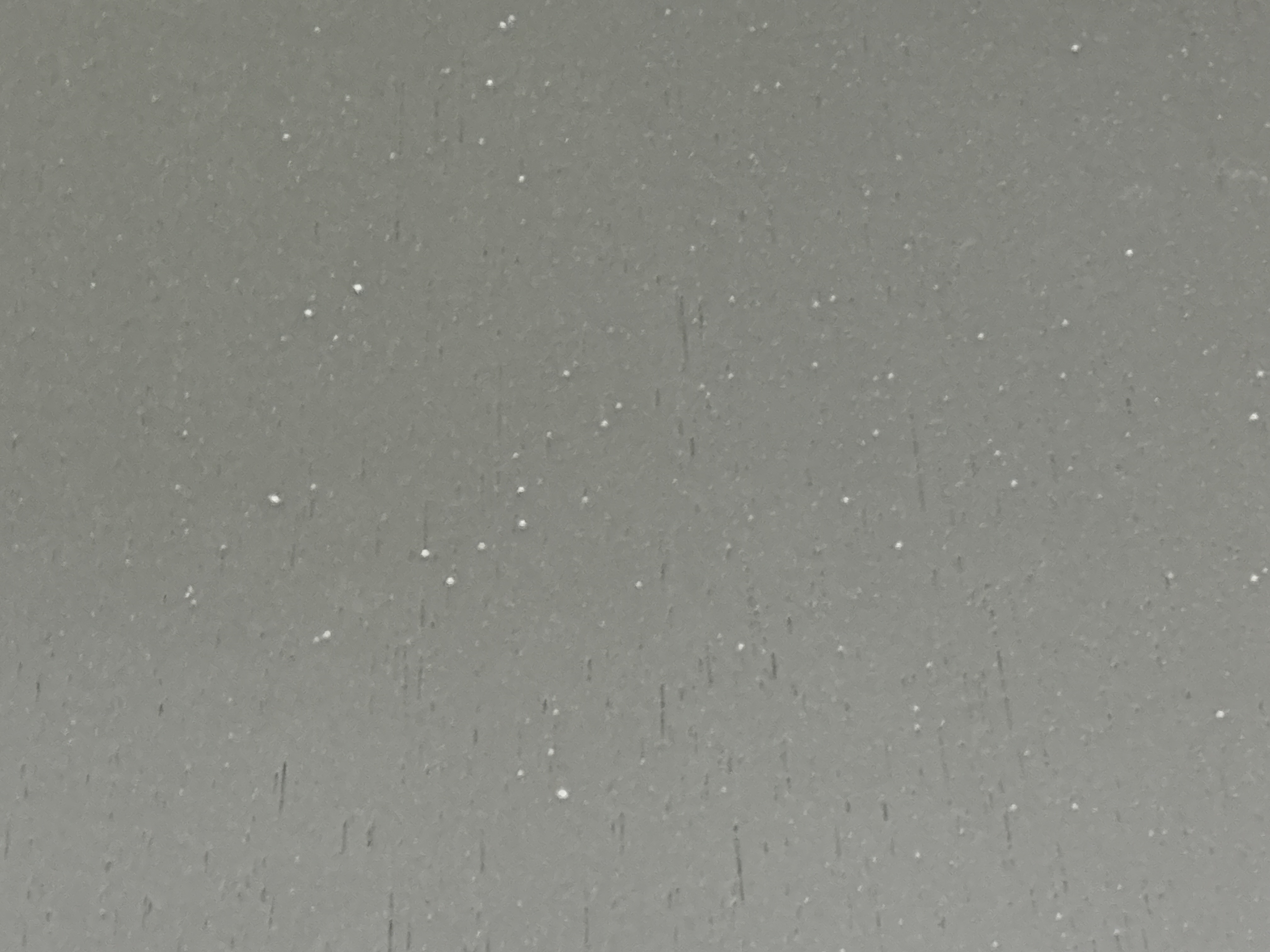

I’m somewhat new to the finish department (9 months) and I’ve been having a lot of trouble trying to train myself without anybody to teach me or certifications etc.. the biggest problem I’m having right now is some kind of solvent pop or micro bubbles or fish eyes, things like that coming up in my finish. I use a AAA CA technologies gun for spraying ML Campbell vinyl sealer and magnaklear, and for those I have the bobcat with only one sized tip. Almost all the stains I use are from ML and I do all of the color matching in house with mineral spirits. That’s a whole thing in itself that I’m slowly learning how to do. Like I said, I don’t have anybody here to teach me how to do this and I’m kind of learning by trial and error, but there are some errors that I keep coming across which I have not been able to find a permanent solution for. Most of the solid pop and micro bubbles. I have been able to solve by putting butyl acetate in the magnaklear but today’s issue was attempting to put black coloring into topcoat of a gravity gun since I didn’t want to ruin my only AAA; and spray black magnifier mix through the cup gun, which worked really well on the smaller pieces that I had but anything more than 12 ft.² is a real pain in the ass to try and drag the cup gun evenly across and spread it perfectly. It doesn’t help that a couple months ago the fan in the fan booth speed regulator has broken so I only have a fan at 100% or 0% so things are drying very quickly and most of the spray is getting sucked towards the fan, which is pretty huge. The entire booth is about the size of a studio apartment. We do lots of mass production at the shop, but I can generally get away with somewhat subpar quality for the industrial commercial jobs but that’s not really what I’m aiming for. I want to be good at this and I would really appreciate any and all tips and help for Things like toning shading glazing. I’ve gotten a hold of a couple of friends who are also in woodworking and wood finishing, but all of them do residential stuff and have never really touched the kind of equipment that I’m messing with here. I’ve been going to the forum here for a couple months, trying to make sense a lot of of it, but most of these terms techniques tools, and so forth are way above my reference of knowledge. That being said, thank you in advance for any and all help.

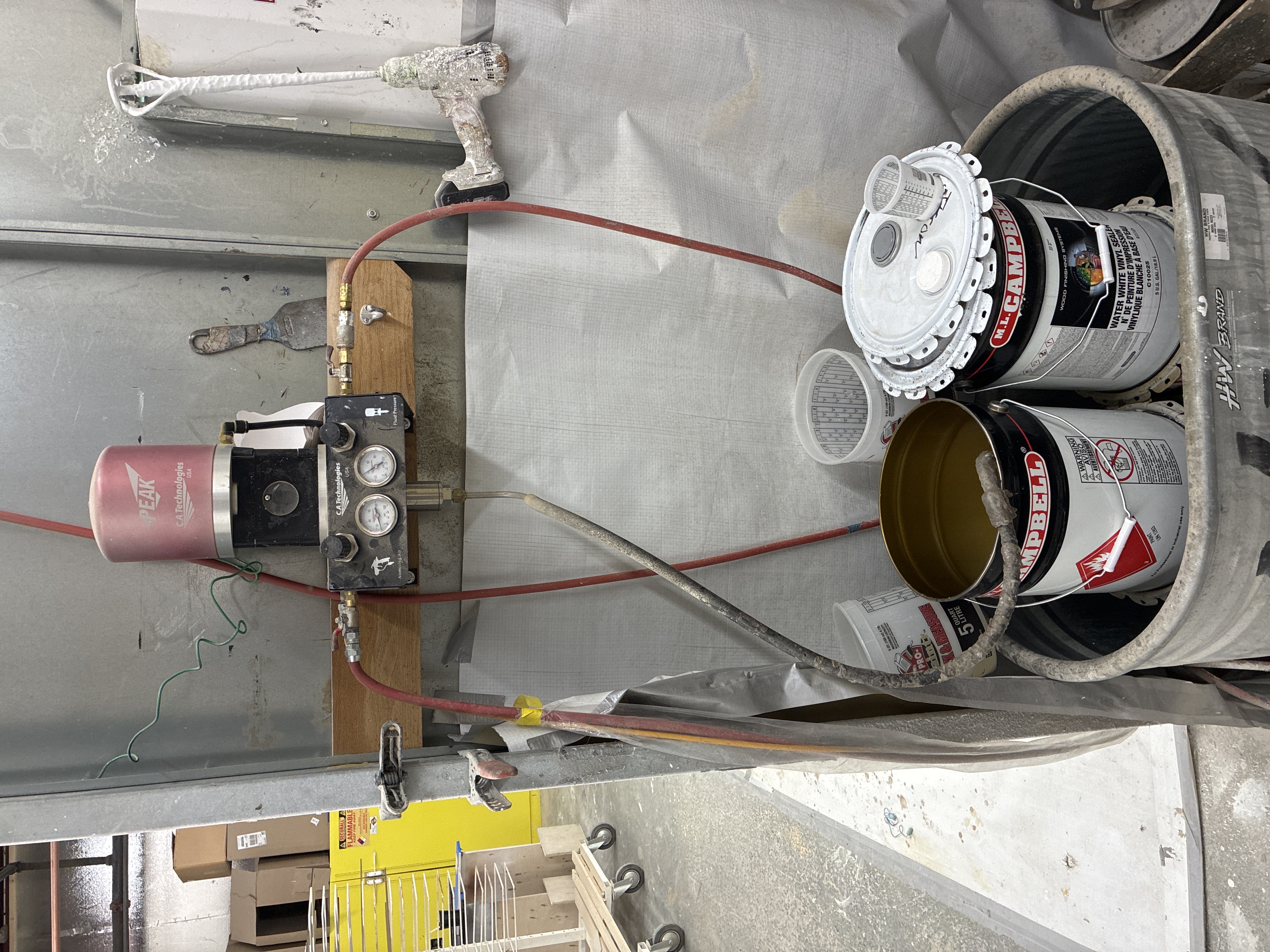

in your last photo you have the pickup tube sitting in an open can. I would get a mixer which sits on top of the can and also keeps debris out.
also get your variable speed fan fixed and invest in some different size tips for your gun.

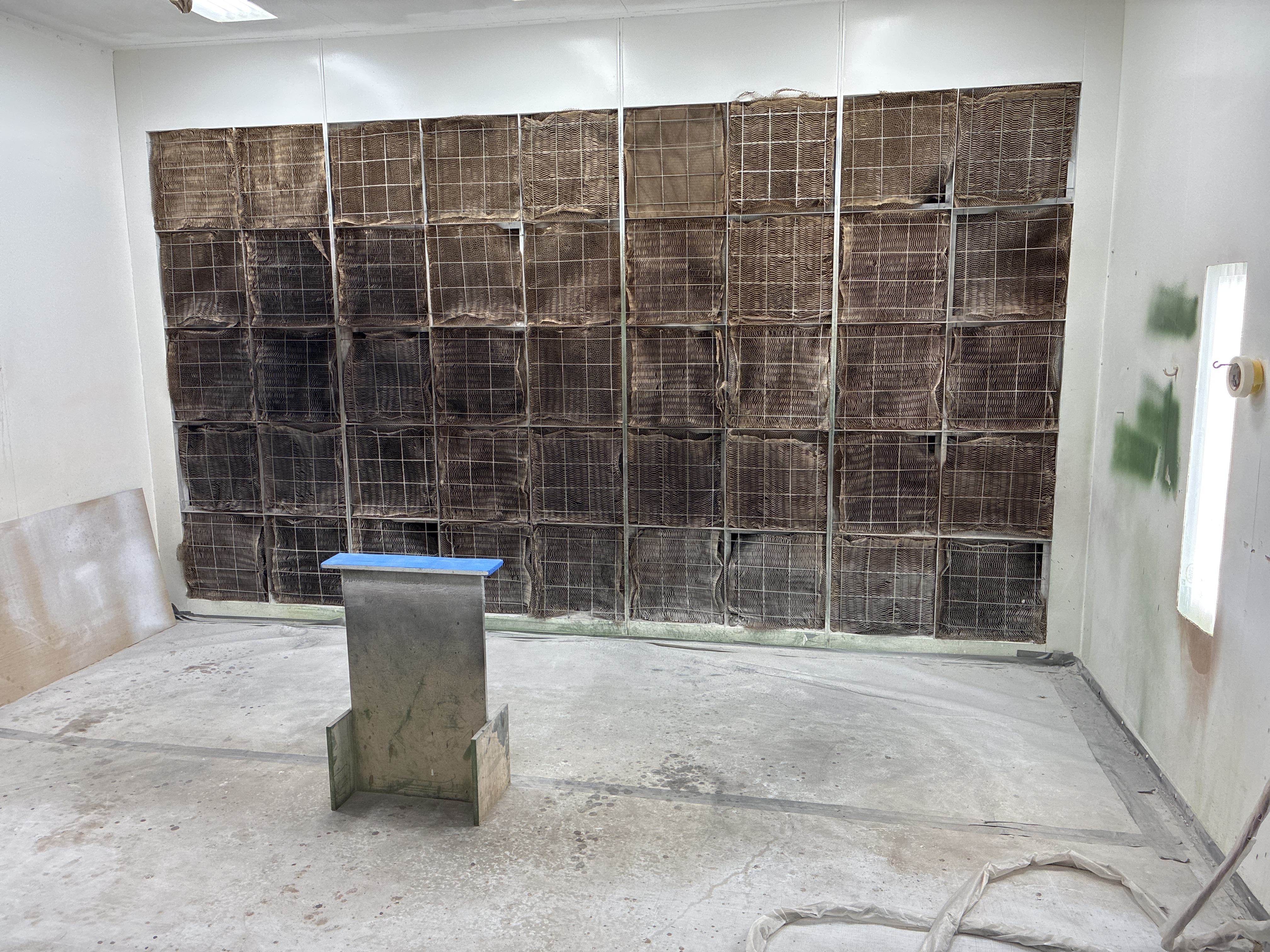

Hey Chris. So the shop manager has had a few electricians and HVAC ppl come look at the VFD and attempt to replace it and/or fix it. I honestly need to get the entire sprayer setup serviced. I’m familiar with magnum sprayers but never used AAA’s before.

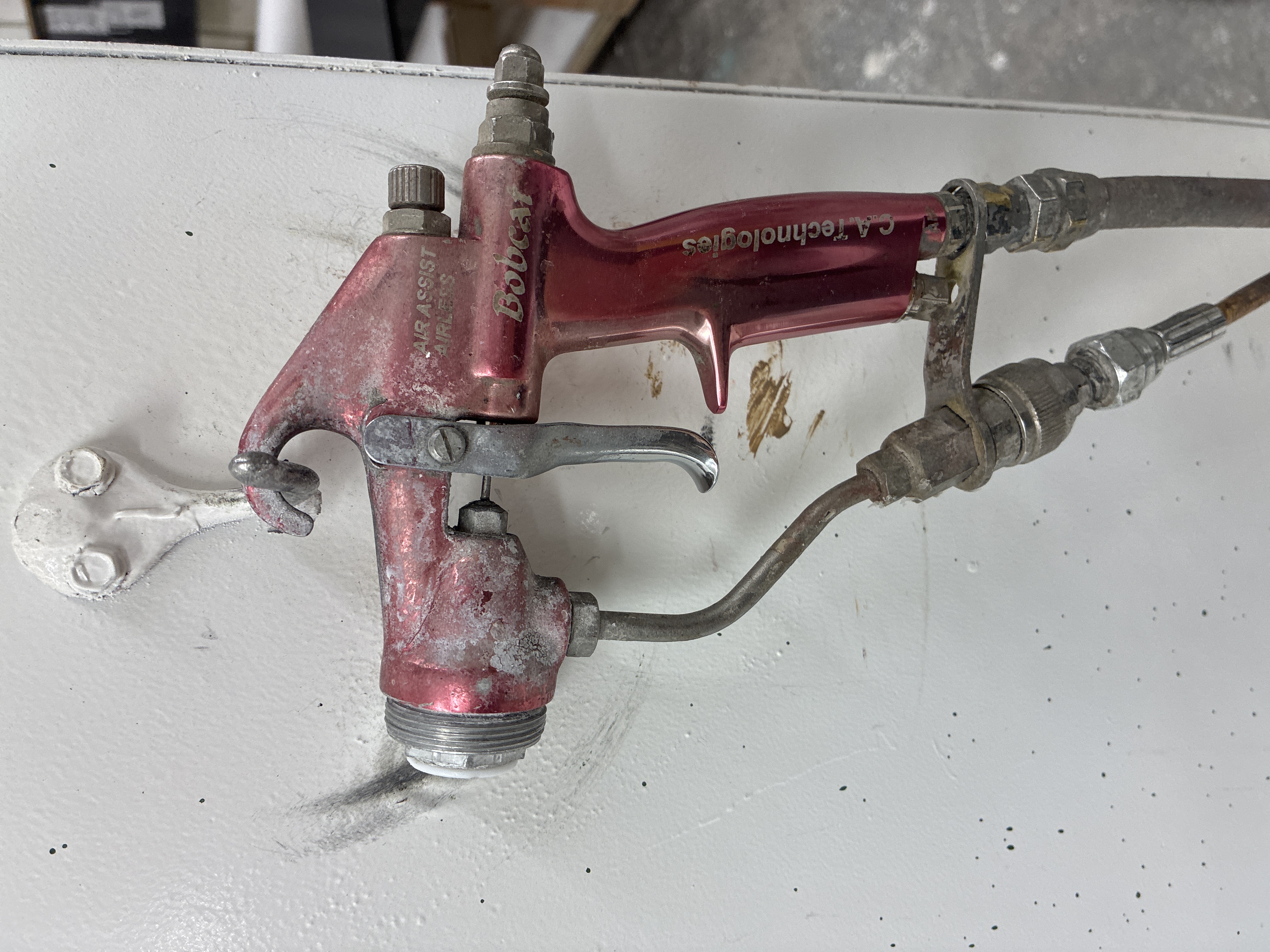

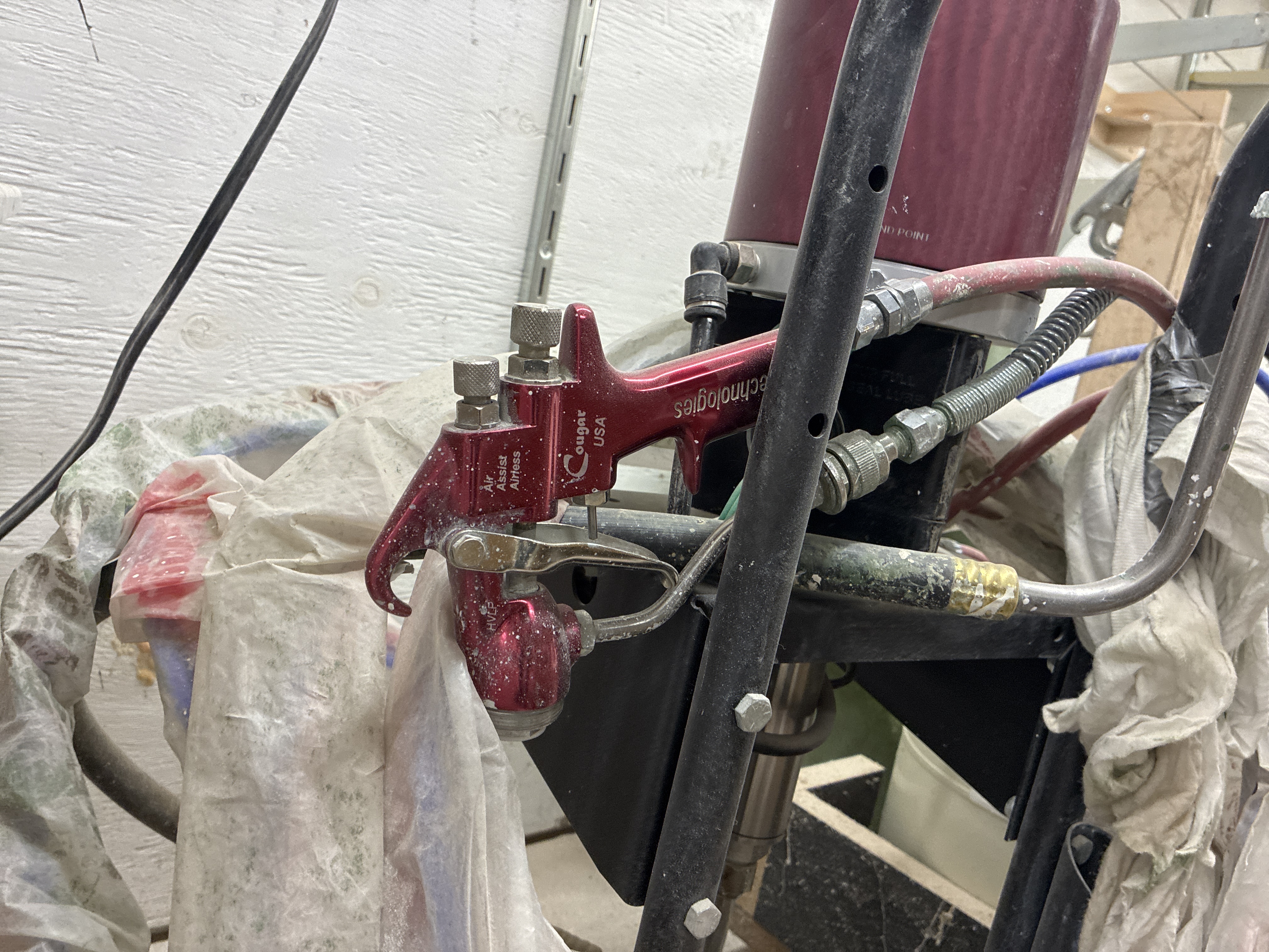

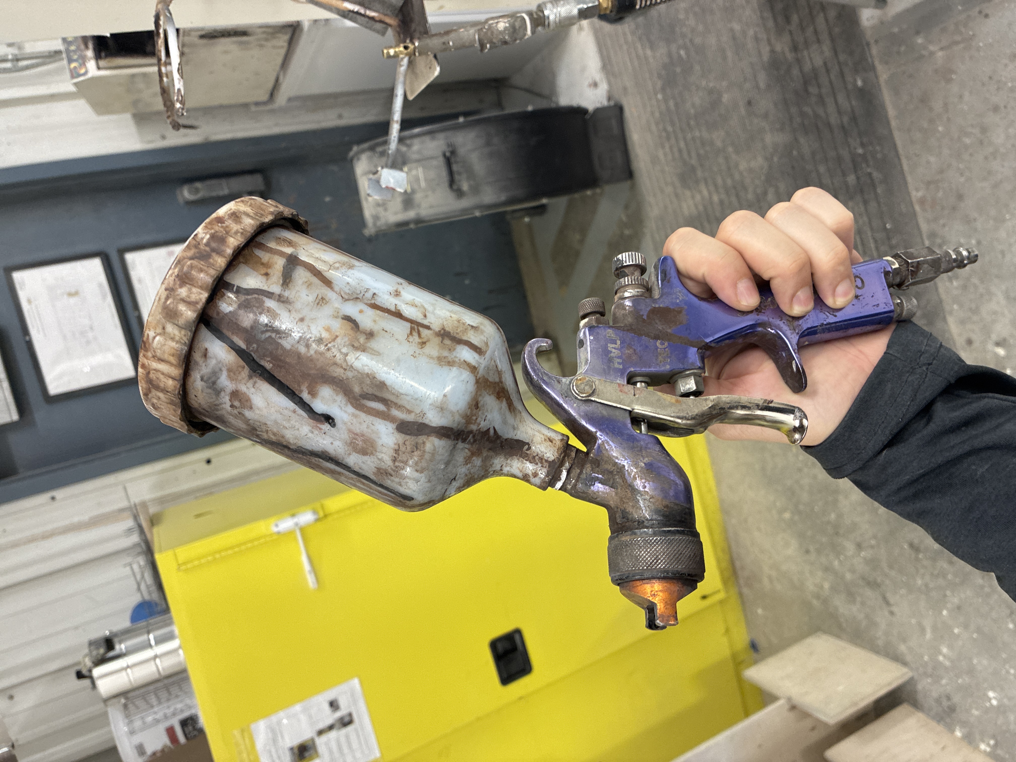

Pics posted are the 3 guns I use here at the shop.

a couple of thoughts do u soak the aircap, if so, stop, here is why
when u drop the air cap into a jar of solvent,, it disturbs all the sediment in the bottom of the container. it will over time and luck, clog the air cap especially the horns of the cap, then mostly, u will get a weird pattern not caused by the spray tip, it will drive u nutz
all u need to do is take a soft bristled brush and clean off any overspray. if u r getting a lot of overspray dirt on ur aircap, in most cases u r spraying to close to ur part and getting bounce back.. u r aircap should remain clean at almost all times except for the above or a seal defect.

2. Solvent poo.....usually occurs when temp is to hot. The top film glaze over faster than it can off Gass and the solvents "pop" through, leaving bubbles. Micro bubbles......it's being sprayed to thick and the top film glaze over faster than it can off gas, leaving micro bubbles trapped in the layers (can appear as a white, milky haze which is thousands of bubbles condensed in a tight area. Easy answer, less is more. Spray 2 thin coats instead of one heavy one. If it's to hot, use retarder (no more than 10% per gallon or it will change the sheen and not dry right.

Herb J the VFD part was ordered and replaced ASAP. However there seems to be some issue with the wiring. The vfd wont communicate with the control board. A couple electricians that checked it out believe it’s something to do with the fire suppression system. As little as I know about finishing, I know even less about electrical work. My background is in house painting so some of the skills and technique carry over like prep work and attention to detail.

ALSO far from electrician, but the fire suppression is supposed to shut down fan in the event of something bad in booth, my guess and only a guess, it is probably a normally open contact that when the fusible link, a device that sort of melts upon excess heat, triggers a closes the contact on the control panel, again far from an electrician
