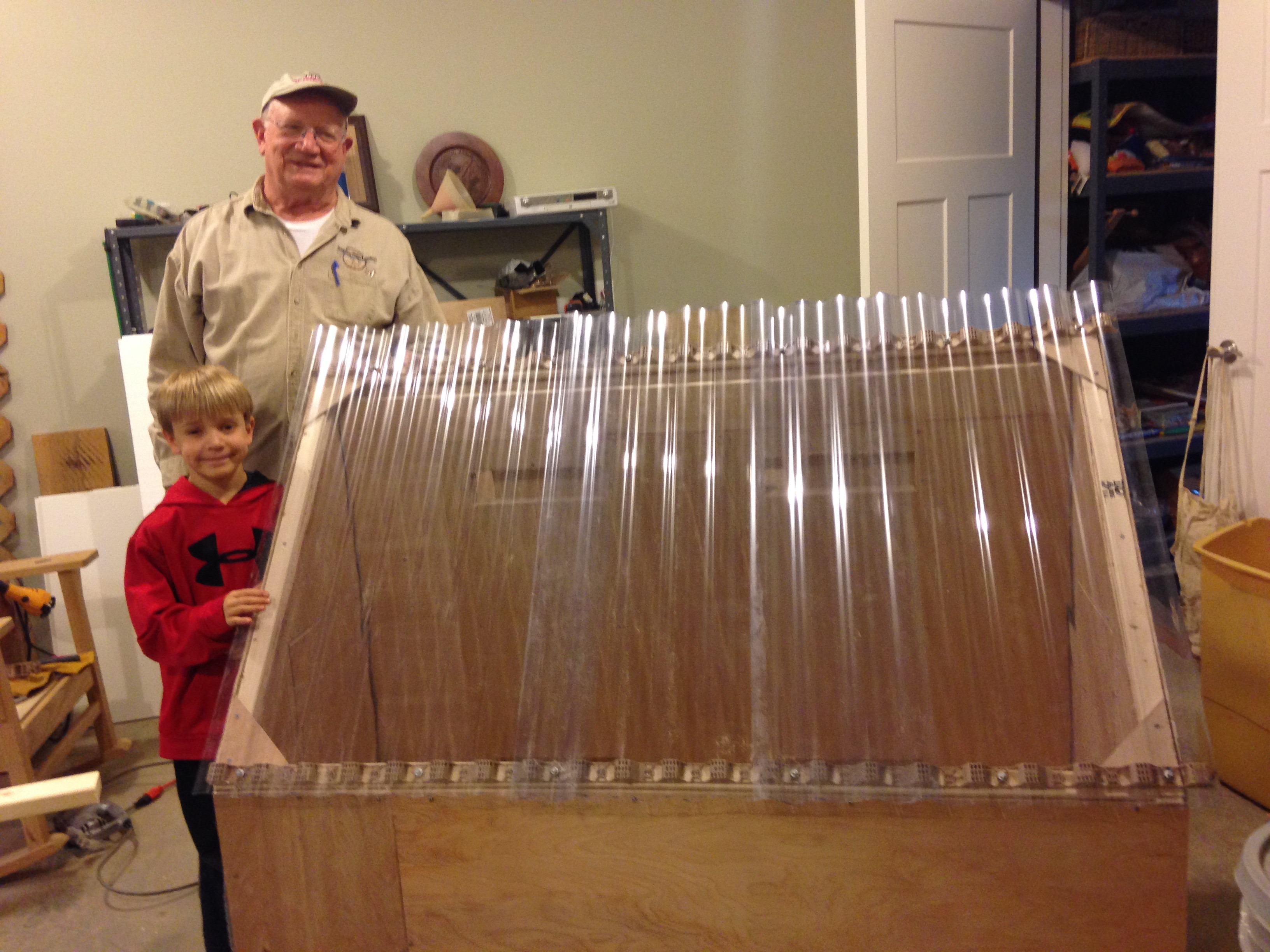

Here is a 1/2 scale model of the kiln that my grandson (8 years) and I built this weekend.

Correction: the capacity is 320 to 360 BF of 4/4 or 420 to 460 BF of 8/4.

Hi, Gene. Sounds interesting. I'll try to make it over there. Great photo of you & your grandson!
