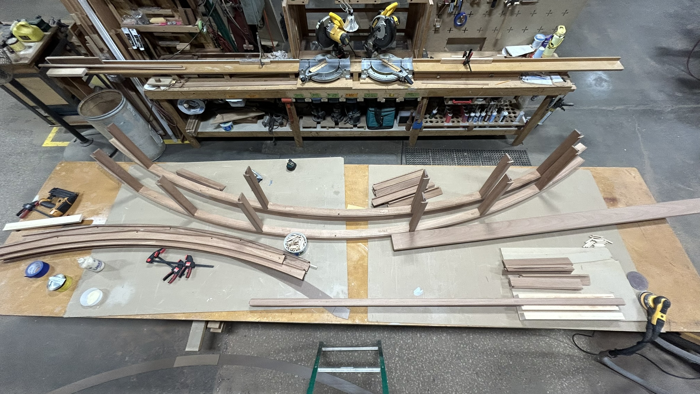

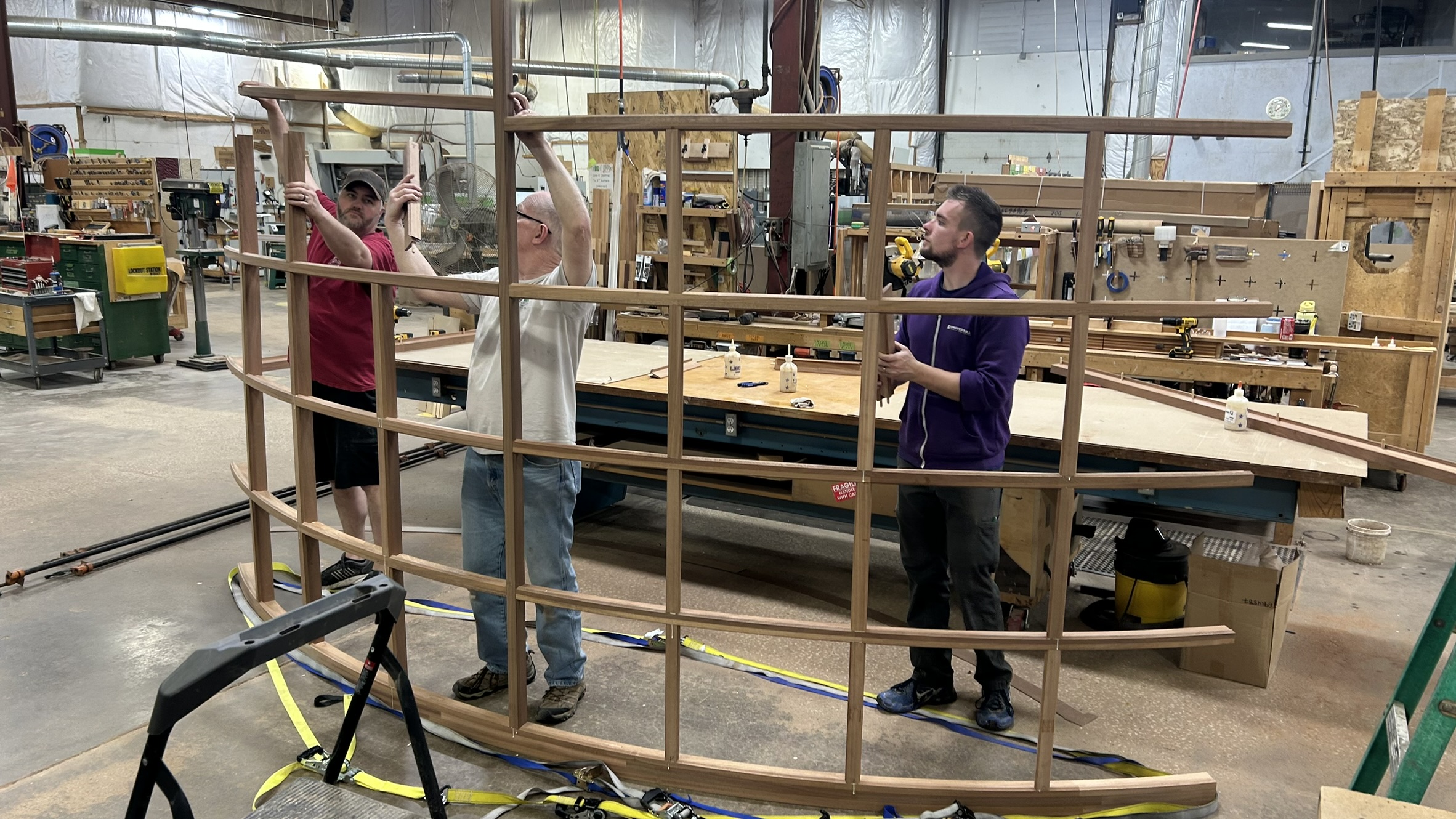

We have a bowed picture window going through our shop currently and would like some feedback on what type of caulk other people use to glaze insulated glass into their doors or windows.
We have used a Nova Bond Pro Hybrid Sealant in the past 12 months. We have 40 pieces of glass going into this project and want to make sure I use the best product(caulk) out there to make this window last.
This window is getting painted. Would like to use silicon for the waterproofing aspects - but silicone does not hold paint. We are glazing the window from the interior of the window.
Process:
1.) We plan to lay a bead of sealant/caulk on the glass rabbet.
2.) then lay the piece of glass into the bed of sealant/caulk
3.) Push the glass into the sealant/caulk to get squeeze out on the other side.
4.) Nail the glazing stops to hold in the glass.
5.) Turn the window over after installing all the glass & glazing stop.
6.) Cut the sealant/caulk
7.) Let it dry over night
8.) Remove the dried excess sealant/caulk the next day
Thanks in advance for the feedback.
Chad
Bowed_Window_Woodweb.pdf

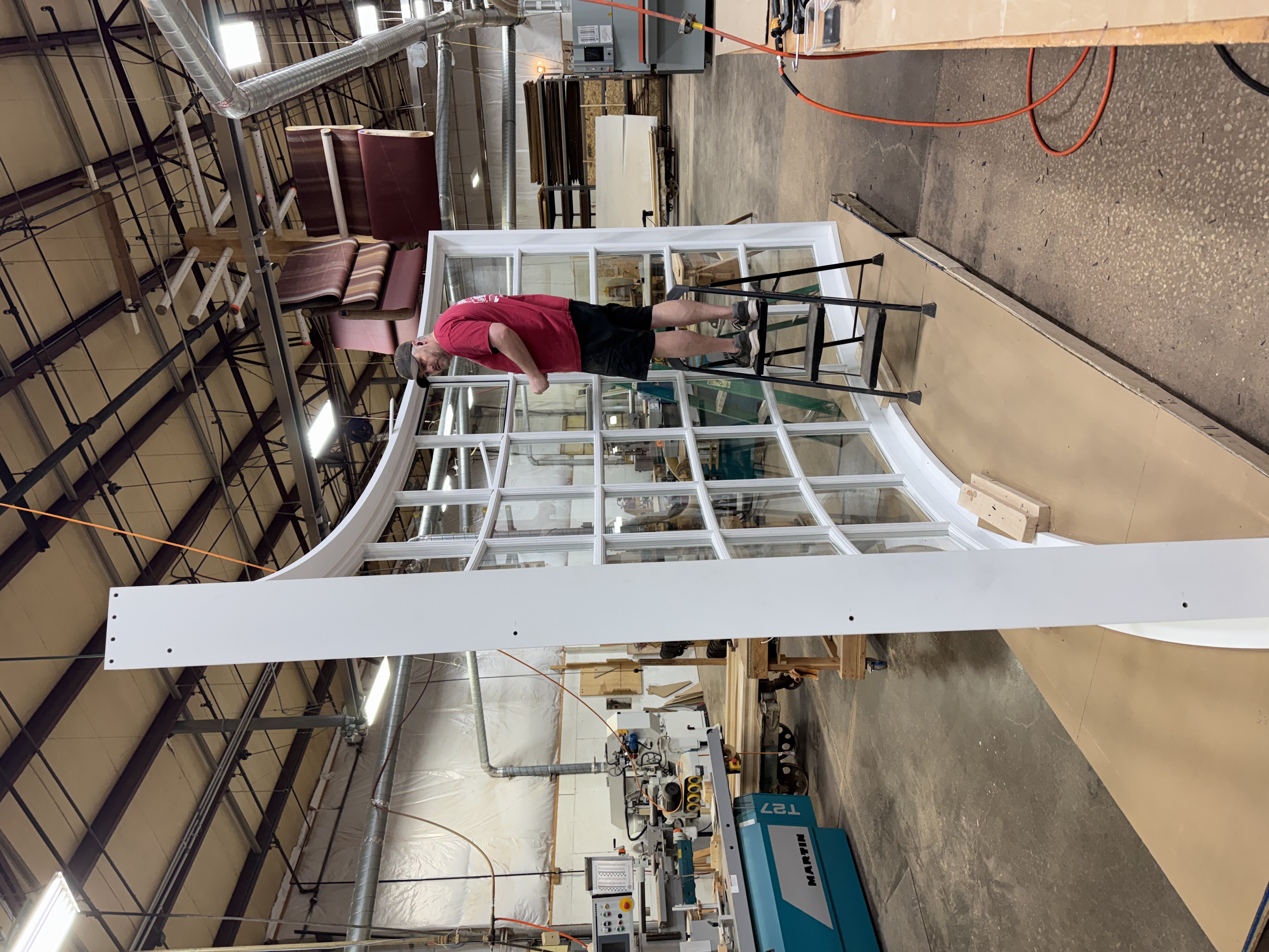

Chad - How is that big Bow Window coming along? You probably have it installed by now. And you are a lot smarter about pricing and managing such a project. Did you have to set glass from the outside, or could you you fit the IGU's in from the inside? Interior stops are a real puzzle.
Photos?
6/22/26       #6: Bowed Window ...
Chad  Member
Website: http://www.adamsarch.com
Hi Dave,
The window is complete and has been installed. The project went better than I expected.
Even though i was never at the job site, I thought the window was too big. This window is massive and thought that the house would never have this big of a window in a older historic home. I am glad to say - it fit!!
We set the glass in our shop from the interior and have the stops cut for each opening. We glazed it before it was shipped to the final destination.
I am glad it all worked out on such a large monumental window.
Chad
